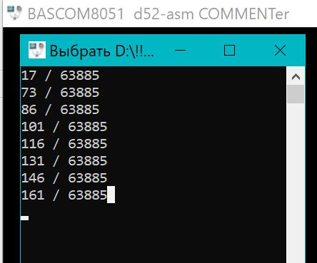

а сколько часов ждать?
я выбрал другой проект
12 минут, процесс не закончен
https://upforme.ru/uploads/0000/25/b8/439/t91277.jpg
How many hours do I have to wait?
I chose a different project.
12 minutes, the process isn't complete.
dont know how it became so slow will invsitgate later..
but at least to know it works
check out this new algo -> https://dropmefiles.com/zkVq0
takes 1 second for your above example
this version 1.1 -> https://mega.nz/file/kk4TELbB#S1DoG8bl4 … -sLSZWoaSk
now works better and faster
you still have some missing BASIC lines, but that because of d52 dissasembler, fail to point some address
maybe in the feature to be improved ;-)
